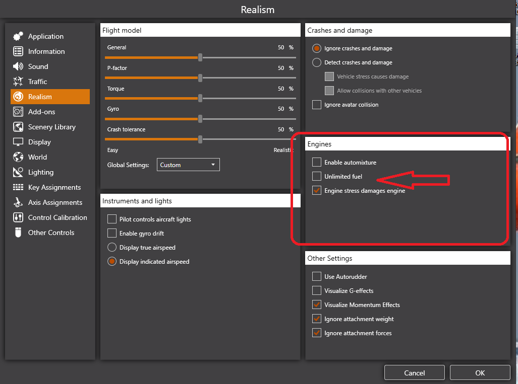

Hi,
In P3D

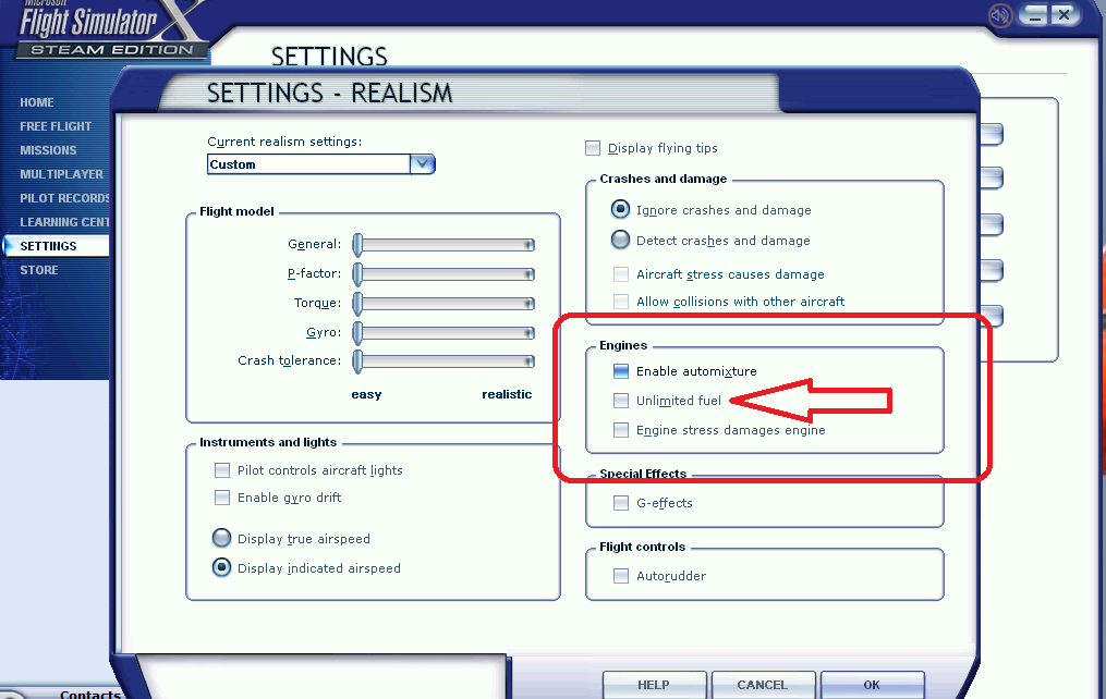

In FSX....
Thank you for your quick response I checked the unlimited fuel box in both sims and they were both unchecked now when i try to load up EZY1874 in both Sims it is saying now unlimited fuel is enabled Flight Phase is showing Preflight I have changed the Aicraft to a B737-800 but I have also tried the Airbus A320 I hava also tried another flight but the same result My Bluesky talks to my main computer from another machine through WideFS I also have three other Acars programms which are all working ok if that is of any consolation

You won't belive this I've just unticked unlimited fuel in FSX & P3Dv3 and everything is now working ok thank you once again for your continued support.
